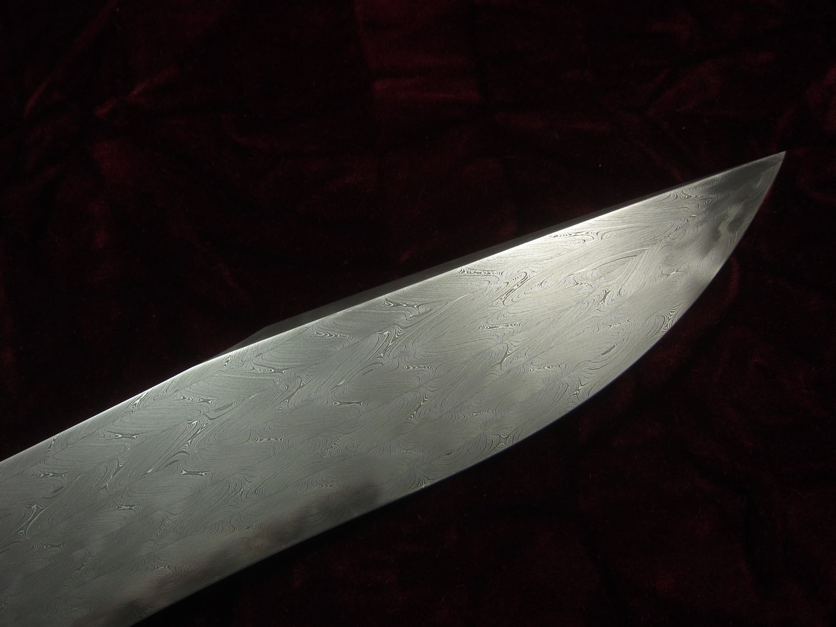

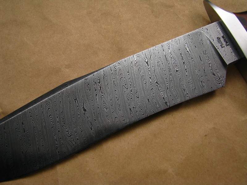

Dennis, the purpose of the twisting is to manipulate the layers of steel to produce the desired pattern, it doesn't affect the performance. This is a variation of the basic twist pattern, where you twist a single bar. Another twist pattern I like is turkish twist. Here's an example of that pattern:
And here's a knife with the same pattern as the chisel will be:

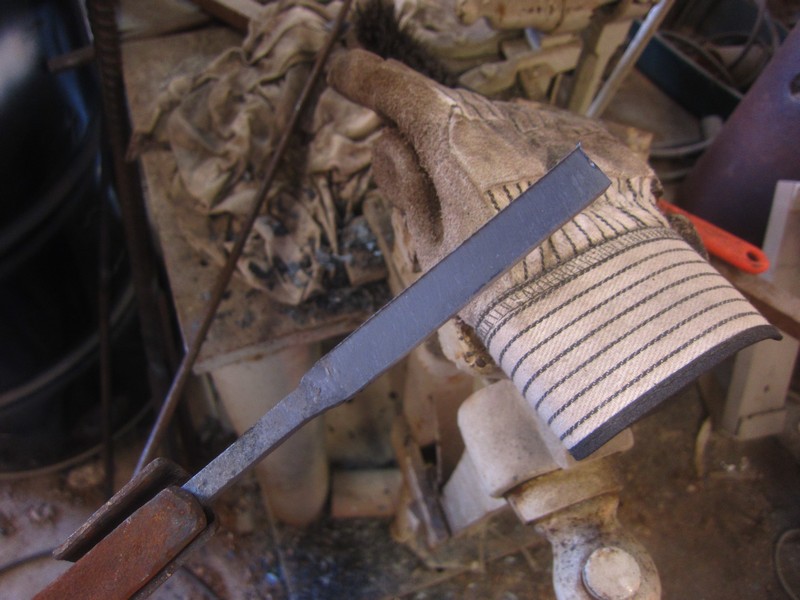

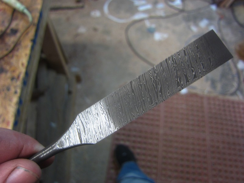

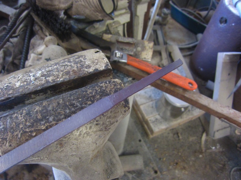

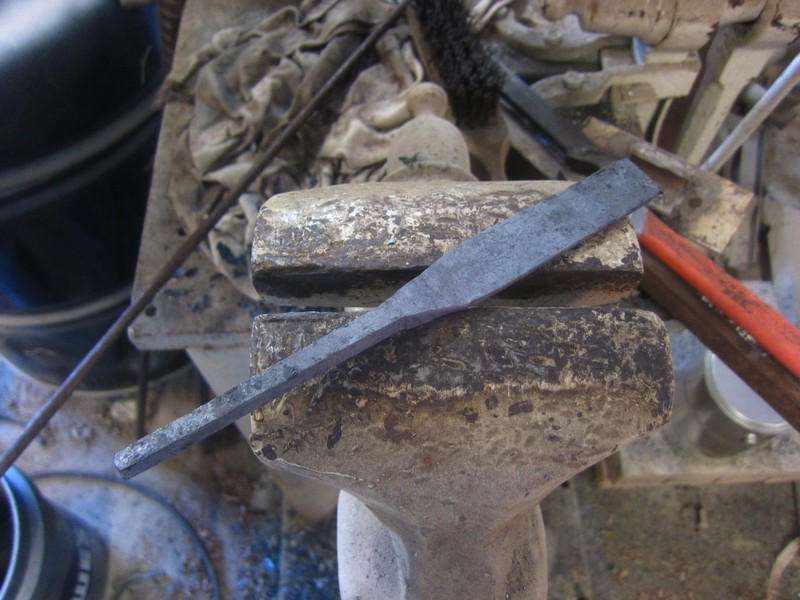

Here's what I got done this morning. First, I ground the bar clean. When twisting a square bar, you make deep grooves, almost like screw threads. The bottoms of those grooves can get forged into the surface, and if you don't grind them out before final forging, you might be in trouble.
Then I started drawing out the tang:
Then the blade part is drawn out width-wise. I was shooting for a finished width of 3/4", so I want it a bit wider to allow for grinding:
Now the whole thing is thermal cycled a few times. This relieves stress and refines the grain.
Once that's cooled down, I'll start grinding.

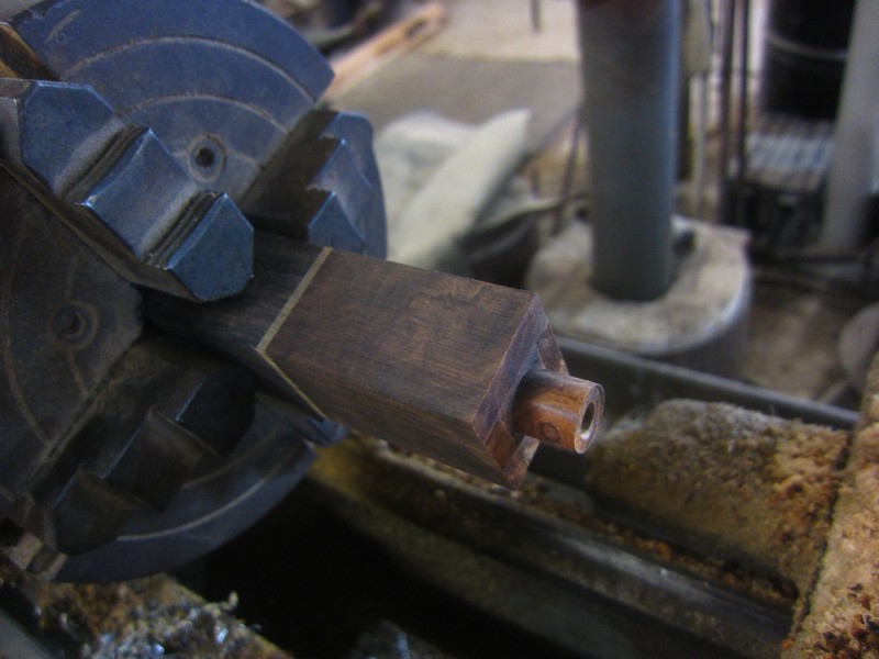

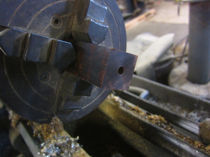

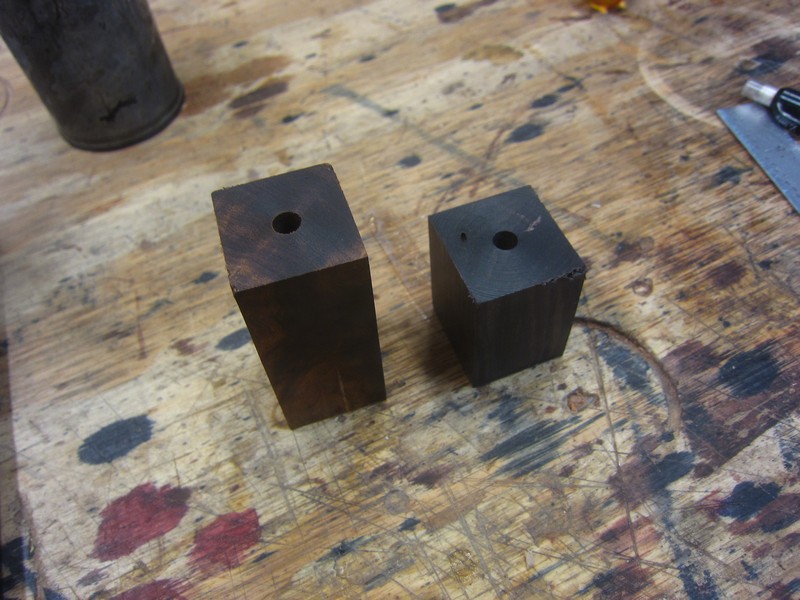

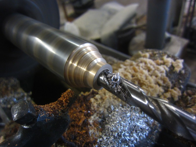

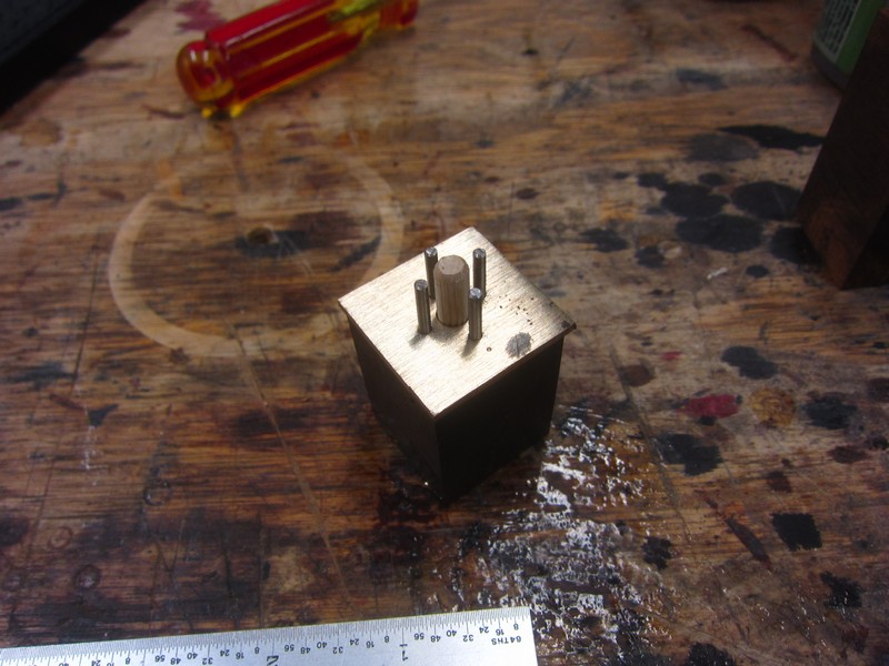

Ok, time to get working on the handle (actually, I made the handle a couple weeks ago, it's just easier for me talk in the present tense ;) ).

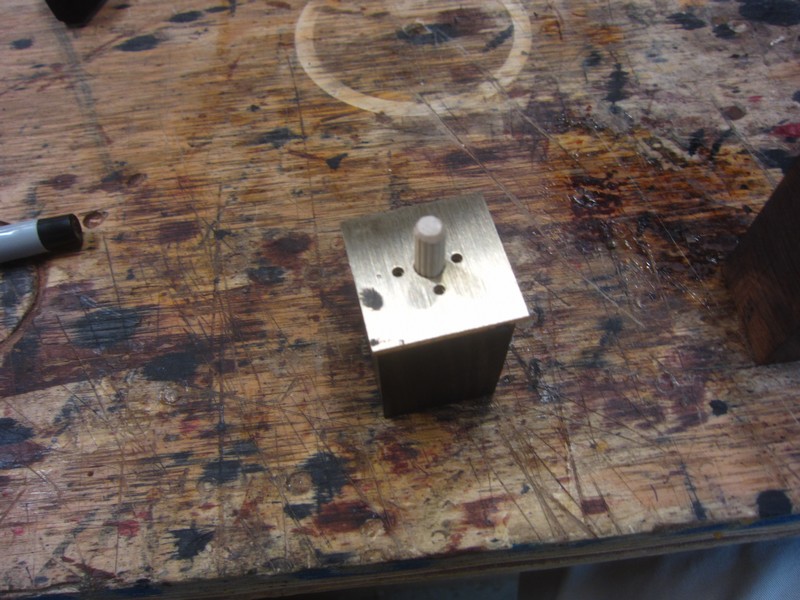

I'm making this handle out of scraps of knife handle wood I had laying around. Arizona desert ironwood and african blackwood.
First step is to clamp the pieces in the four jaw chuck on my lathe:
and drill all the way through one piece, and most of the way through the other:
I'm using a piece of bronze between the two pieces of wood to add contrast and to keep them lined up right:

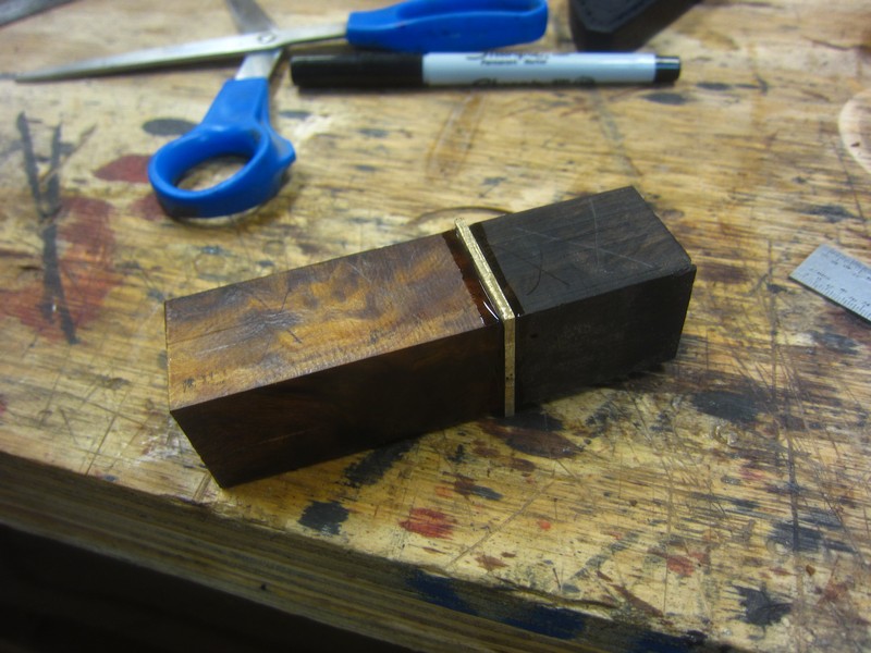

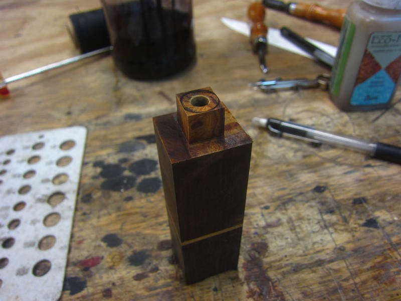

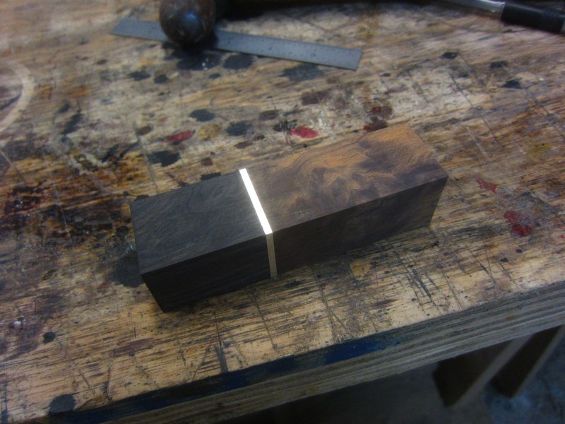

Now the pieces are all glued together (using CA):
then ground clean:
Then I hog off the material where the ferrule will be using the bandsaw:
Then chuck it up in the lathe again and turn it round:

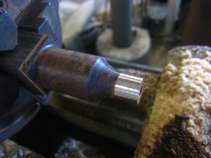

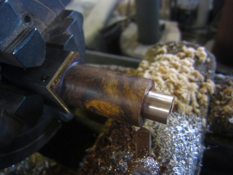

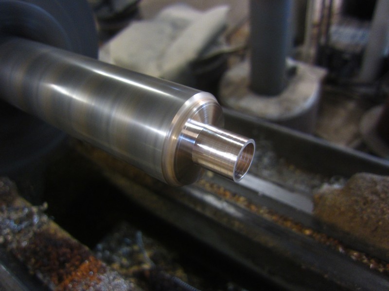

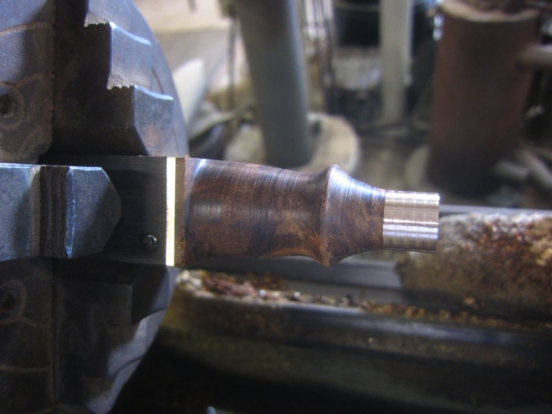

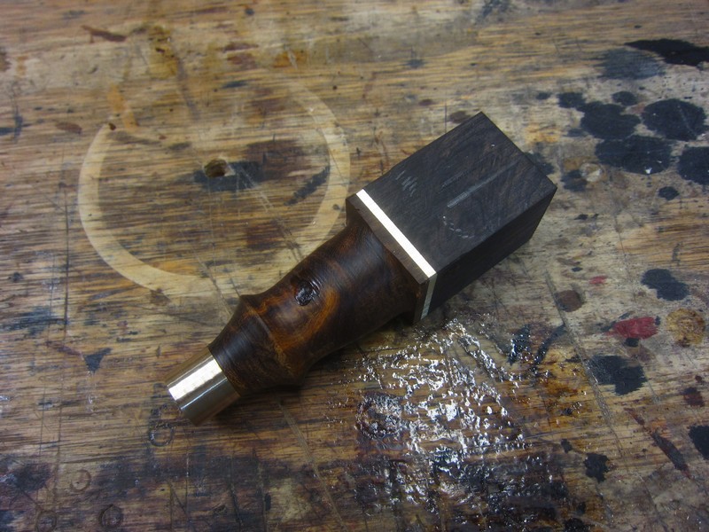

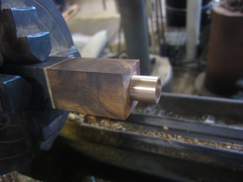

Now for the ferrule. I'm making it out of bronze also, and the only turning stock I had was 1.5" diameter. But, it was partly turned down to size from a previous project. [:Y:]
Now the ferrule is cut off, and glued to the handle blank:
And the handle starts to get shaped:

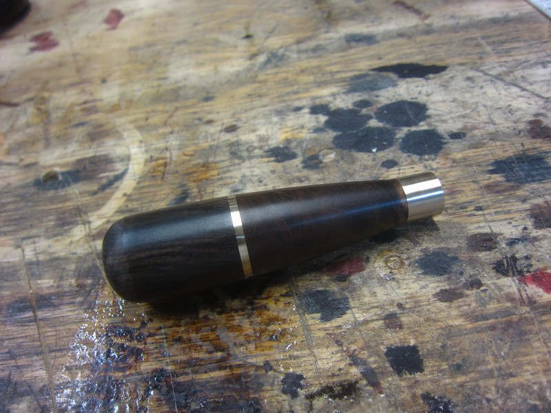

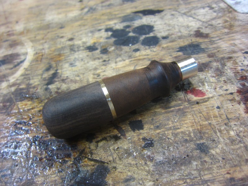

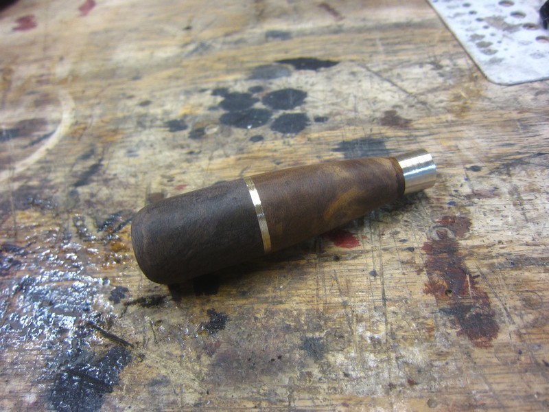

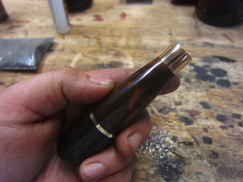

Initially, I shaped it with a thumb stop:
but didn't like the way it felt, so I ground it off. The spacer in the handle is a different kind of bronze than the ferrule, and is very hard to machine, so all the shaping after the above pics, were done free hand on the belt grinder.
After rough shaping, it was sanded with slack belts through 600 grit, then buffed:
Tomorrow, I'm hoping I'll be able to heat treat the blade.

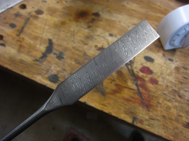

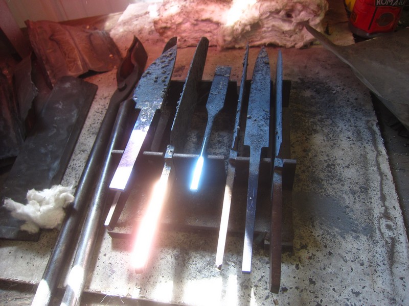

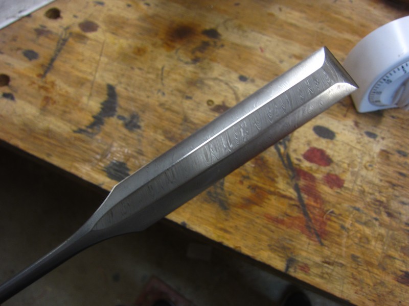

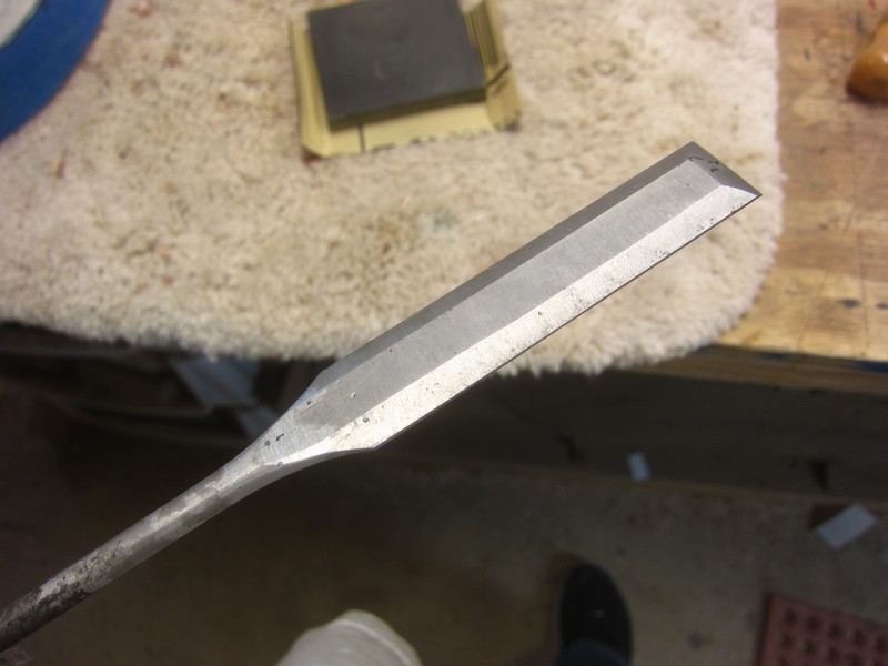

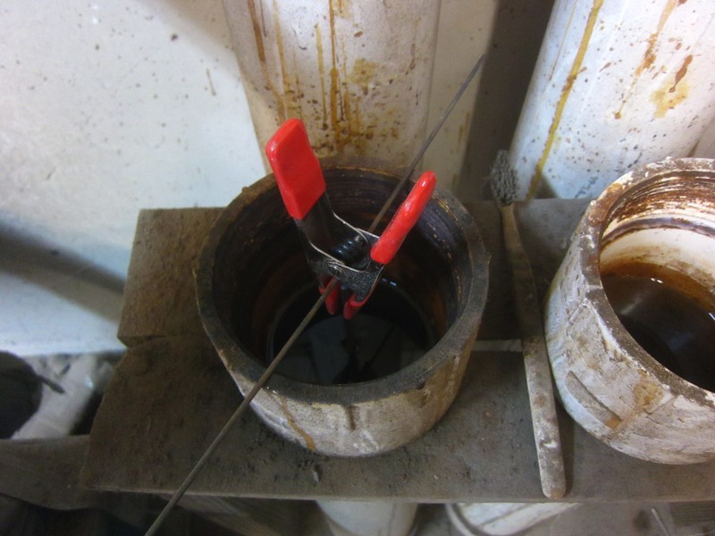

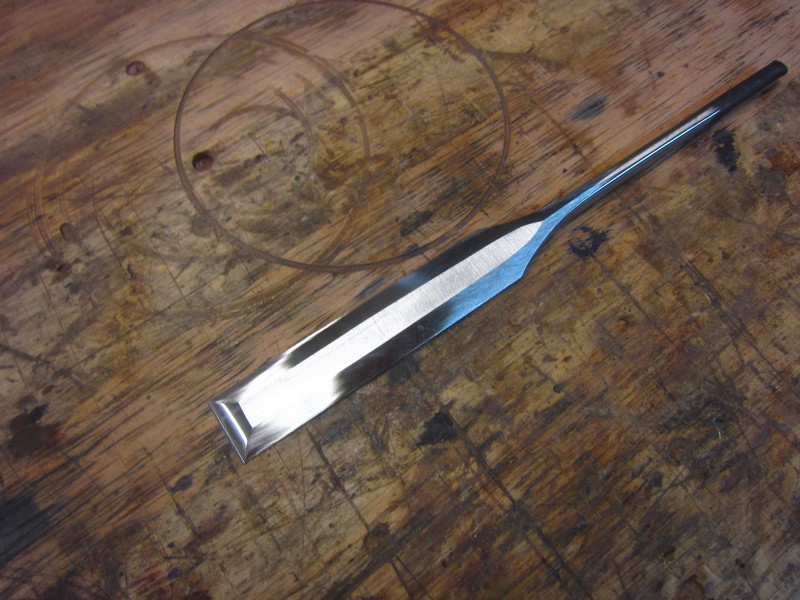

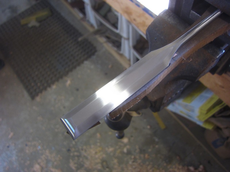

Well, I didn't get around to heat treating until Friday, because I wanted to get a bunch of knife blades ready to do at the same time, to conserve energy. So here's the chisel:
and here are the knives I did:
The gray coating you see is anti scale compound. It protects the surface from the effects of oxygen at high temps.
Here it is after quenching. The steels I used for the chisel are shallow hardening, so require a fast quenchant. Traditionally, this was done in the urine of a red headed virgin, but it's hard to find virgins nowadays, so I use a quench oil designed for fast steels. It's almost as fast as water, but without the risk of cracking, which would be very disgusting this far along...

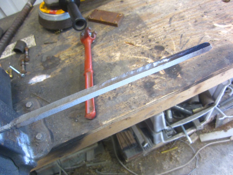

After tempering, which is done twice at 350 degrees for a couple hours, it's back to the grinder to clean up the grinds, trying to make everything symmetrical and straight:
I finished up on the grinder with 240 grit, then went to 400 grit by hand:

Then into the etching tank. I etch in ferric chloride. I like a fairly weak solution, because I think it looks nicer to do many slow etches, with light sanding in between, than to do a couple deep etches.
I etch for 10 minutes, and here's how it looks:
Then sand with 600 grit, etch for 10 more minutes, then buff with a fairly hard wheel and green chrome compound:
Then etch for another 10 minutes, then it goes into the neutralizing bath, which is just water and baking soda.
